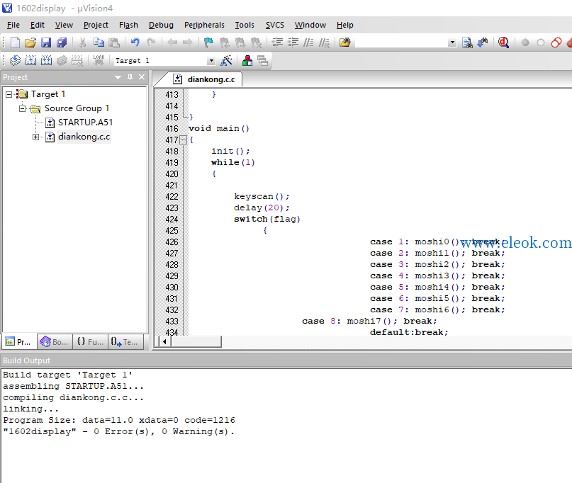

  405.                         }
  406.         }
  407.
  408. }
  409. void main()
  410. {
  411.         init();
  412.         while(1)
  413.         {
  414.
  415.                 keyscan();
  416.                 delay(20);
  417.                 switch(flag)
  418.                         {
  419.                                      case 1: moshi0(); break;
  420.                                      case 2: moshi1(); break;
  421.                                      case 3: moshi2(); break;
  422.                                      case 4: moshi3(); break;
  423.                                      case 5: moshi4(); break;
  424.                                     case 6: moshi5(); break;
  425.                                       case 7: moshi6(); break;
  426.                                case 8: moshi7(); break;
  427.                                       default:break;
  428.                 }
  429.         }
  430. }
